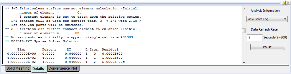

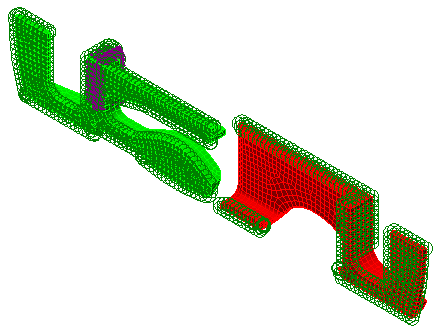

The first time an analysis is run, the solid mesh is generated within the interior of each part. When solid meshing is complete, the solution starts. While the solution progresses, the solver log is displayed in the Details tab of the Output Bar (located at the bottom of the Simulation Mechanical window):

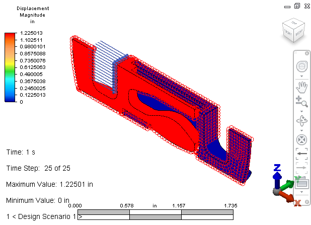

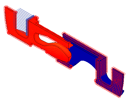

During the solution, the display updates with each completed time step. You do not have to wait for the simulation to finish to see the partial results. As the two parts come together, you can watch the spring part deflect as it is inserted and then snaps into place in the buckle part.
Depending upon your software version and settings, the load and constraints may be shown or hidden by default.
After a few minutes, the solution should finish:
