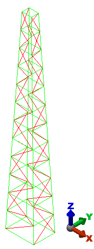

Since the cross-sectional area of the diagonal cross members is different from the horizontal and vertical members, they must be placed in a different part.
Navigate
Orientation
Front View.
Draw
Line.
Navigate
Orientation
Right View.
Navigate
Orientation
Back View.
Navigate
Orientation
Left View.
Navigate
Orientation
Isometric View. The tower should display as shown in the following image.
Save on the Quick Access Toolbar (QAT) to save your model. This tutorial is now complete. You can use this model to complete the Truss Tower Natural Frequency - Modal Analysis tutorial.
