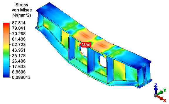

    The maximum Von Mises stress is now approximately 88 N/mm2, which is below the allowable stress of 90 N/mm2. The stress results appear as shown in the following image.
    Note: The selection of the von Mises Stress contour plot and the activated state of the Maximum results probe have been retained from the previous analysis review session.

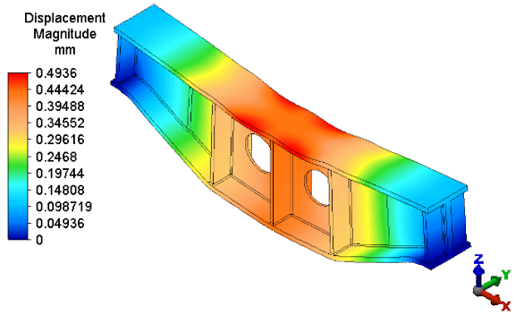

  3. Click Results Contours Displacement Displacement Magnitude. The maximum displacement is now slightly less than the allowable displacement of 0.5 mm, as shown below.
