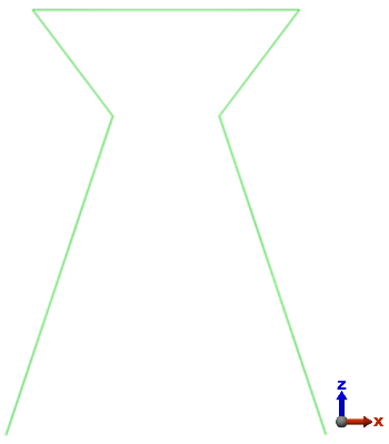

Front View. We are drawing lines in the XZ plane.
Draw
Line. Then...
Navigate
Enclose. The model should display as shown in the following image.
