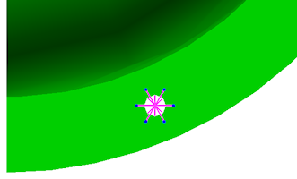

Selection
Shape
Point or Rectangle command active, click the surface of the flange facing the screen, as shown pre-highlighted in yellow in the image below.

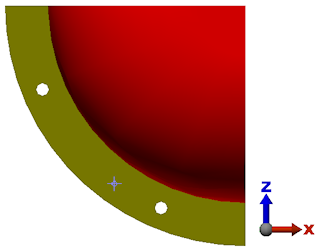

Navigate
Orientation
Back View.
