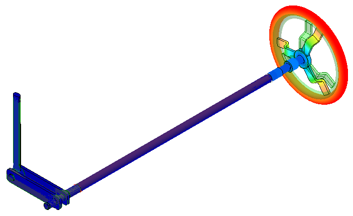

Next, we will look at the displacement results with a transparent view of the undisplaced shape superimposed on the displaced view. Then, we will look at the rotational displacement and stress results.
  1. Select Results Contours Displacement Show Displaced Displaced Options command.
    1. Click Transparent. The display appears as shown in the following image. Note that the displacement is almost purely torsional. That is, the hand wheel is rotating about its center.

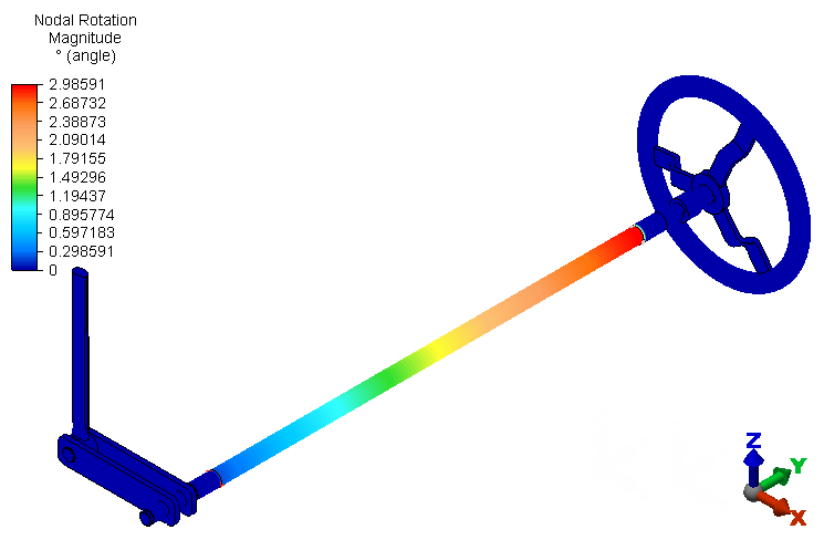

  2. Click Results Contours Displacement Rotation Magnitude. The Rotation command is in the pull-out portion of the Displacement panel. The Magnitude command is in the drop-down menu of the Rotation command. The rotation magnitude (twist) of the beam elements at the wheel end of the assembly is approximately 3 degrees.
    Note: Rotational displacement results are available for beam elements because beam elements support rotational degrees of freedom (DOF). However, only translation DOF, and therefore only translational displacement results, are available for brick elements. For this reason, all of the brick parts show a zero-rotation result.

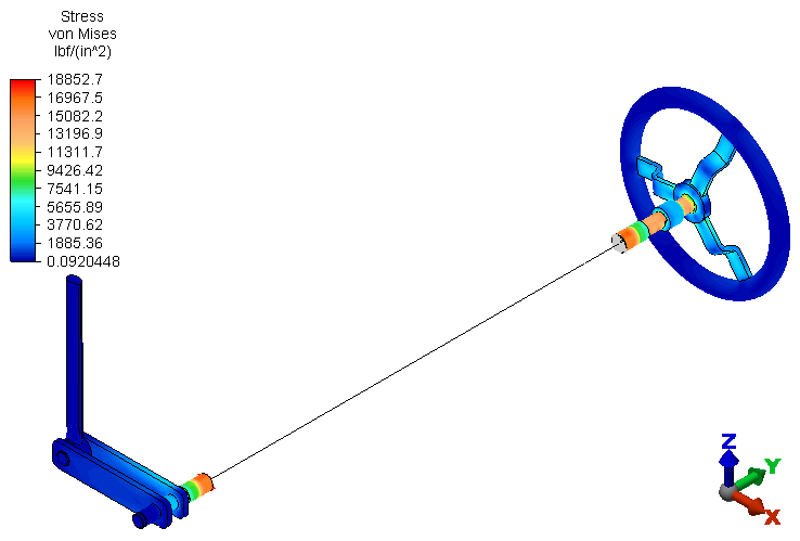

  3. Click Results Contours Stress von Mises. The model displays as shown in the following image. The highest stresses occur in the hand wheel shaft and the solid and hollow portions of the shaft spanning between the hand wheel and the remote crank subassemblies. Von Mises stress results are not applicable to the beam or rigid elements.

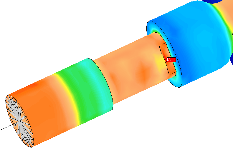

    Here is a view with the model viewpoint rotated and zoomed in to clearly show the maximum stress region. Additionally, the Maximum Probe ( Results Inquire Probes Maximum) has been turned on to indicate the maximum stress location.

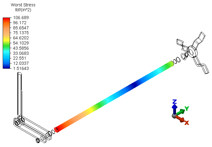

    Next, we look at the beam Worst stress results.
  4. Click Results Contours Stress Beam and Truss Worst. The following stress contour plot appears:
    Important: The beam element formulation only calculates bending and axial stresses. Beam elements do not provide torsional stress results. The subject beam elements have no axial load and only a very small bending moment due to the reaction force at the partial link, which acts at a short distance from the shaft support. That is why the reported stress magnitude in the beam elements is so small. Use the preceding Von Mises results at the short brick-element portions of the hollow shaft (or the XY or YZ stress tensors) to account for the torsional stresses.
    Note: Though the beam elements do not produce torsional stress results, they do provide correct torsional displacement results. The element formulation includes the torsional resistance property, and therefore behaves with the correct torsional stiffness.

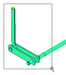

  6. Click View Navigate Zoom Window.
    1. Click and drag your mouse to draw a zoom area window enclosing only the partial link and crank, as shown in the following image:
    2. Press Esc to terminate the Zoom Window tool.

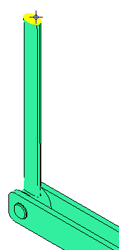

  7. With the Selection Shape Point or Rectangle and Selection Select Surfaces commands active, click on the top surface of the partial link, as shown below (pre-highlighted in yellow):
  8. Right-click in the display area and choose Select Related Nodes from the context menu. All of the nodes on the top surface of the partial link are now selected.
  9. Click Results Inquire Inquire Current Results. The Z-reaction results are listed for each of the selected nodes.
