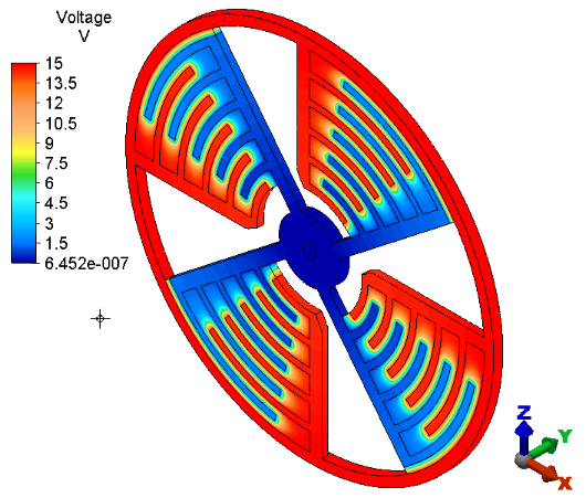

  1. Click Analysis Analysis Run Simulation. The analysis proceeds and the model displays in the Results environment.
  2. Click Results Options Voltage and Field Strength Voltage to display the voltage distribution. Do not be concerned if your result for the minimum voltage (at the bottom of the legend) does not exactly match the image below. This number is essentially zero for all practical purposes.
