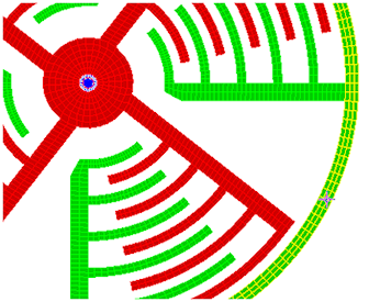

Now we apply appropriate constraints, including a 1D rotational spring support, to the ends of the mounting beam and a fixed boundary condition to the static comb (Stator).
Navigate
Orientation
Top View.
Selection
Shape
Point or Rectangle and
Select
Vertices commands active, click the node at the top of the vertical beam element (+Y end) as currently viewed (see image below).
Setup
Constraints
General Constraint.
Setup
Constraints
1D Spring Support.
Setup
Constraints
General Constraint.
Navigate
Orientation
Back View.
Select
Surfaces command active, select the face of the ring at the outside diameter of the motor, as shown highlighted below (yellow on green).
Setup
Constraints
General Constraint.
