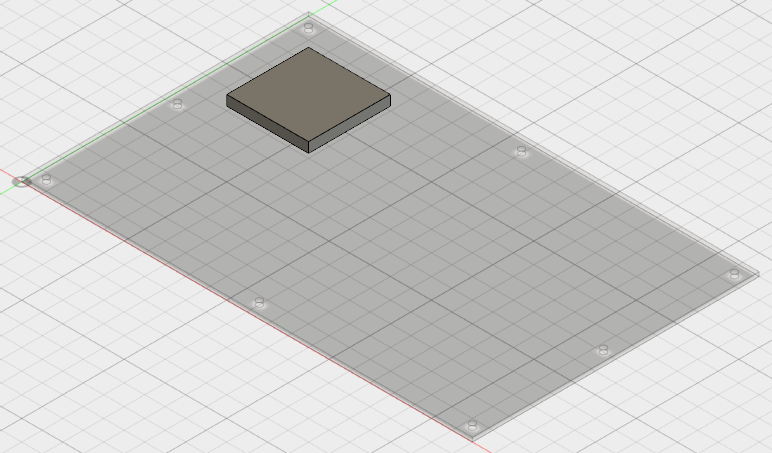

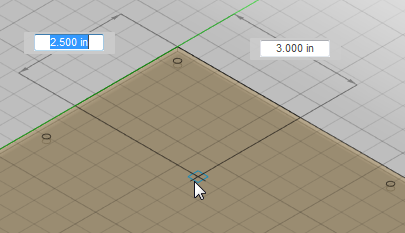

Add the chip to top of the circuit board and then position it at the specified distances from the board edges. Initially, create the chip so that its uppermost corner is coincident with the uppermost corner of the board (as oriented in the Home view). Then, move it 1.0 inch away from both the short and long edges of the board.
CREATE
Box.
MODIFY
Move. The MOVE dialog box appears.
Save.
