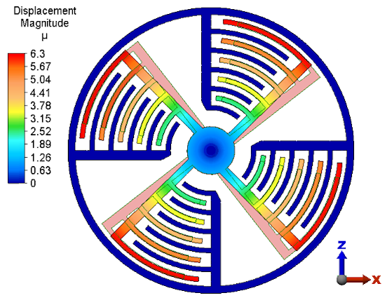

Run Simulation. The analysis proceeds and the model displays in the Results environment. By default, the displacement magnitude is presented initially. Next, we display the actual deformed shape (absolute scale = 1) and overlay the undisplaced shape as a transparency over the displaced results.
Results Contours
Displacement
Show Displaced
Displaced Options.
