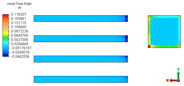

We can calculate the total heat flow from the chip to the board.
Results Contours
Heat Flow
Heat Rate Through Face.
Results Contours
Settings
Smooth Results to deactivate this option. Smoothing must be turned off to inquire about face- or element-based results.
Navigate
Orientation
Bottom View. The model displays as shown in the following image:
Selection
Shape
Point or Rectangle and
Select
Surfaces commands active, click on the bottom of the chip.
Results Inquire
Inquire
Current Results. This tutorial is now complete. Use the results of this model to complete the Circuit Board Transient Heat Transfer Analysis tutorial.
