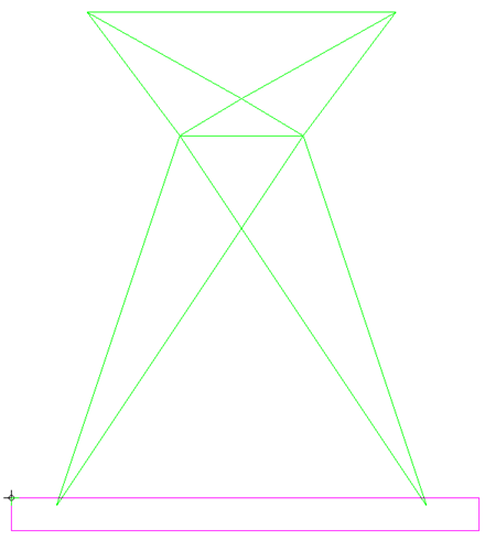

Next, we will apply fixed boundary conditions to the two nodes at the bottom of the model.
View
Navigate
Orientation
Front View is displayed.
Selection
Shape
Point or Rectangle and
Select
Vertices commands active, click and drag to draw a box enclosing the bottom of the model, as shown in the following image. Ensure that only the bottommost two nodes are selected.
Setup
Constraints
General Constraint.
