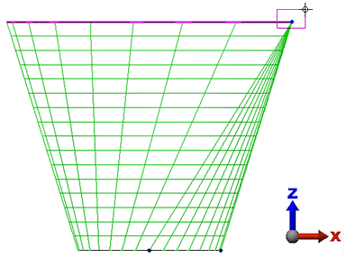

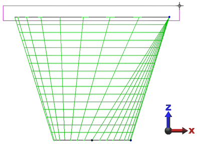

Lines commands active, click and drag to draw a selection rectangle enclosing the top edge of the model.
This removes the lines along the straight edge from the selection set. We do not want to copy these lines because that would produce a wall in the middle of the cylinder.

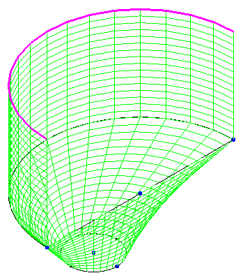

Pattern
Move or Copy.
Navigate
Orientation
Isometric View. The model displays as shown in the following image.
