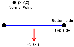

- Normal Point (X), Normal Point (Y), and Normal Point (Z). A point in space is used to control the orientation of the element's normal axis (+3 axis), or which side of the element is the top side (+3 side) and the bottom side (-3 side). The normal direction is determined by specifying a point in space using the Normal Point (X), Normal Point (Y), and Normal Point (Z) columns. See Figure 2. A positive normal pressure is applied normal to the plate elements in the direction of the +3 axis and points away from the element normal point.
Tip: The normal point does not need to be over the element as implied by Figure 2. Mathematically, the side of the plate element that faces the element normal coordinate is the bottom of the element.
Figure 2: Determining the Element Normal The edge-on view of the plate element is shown.

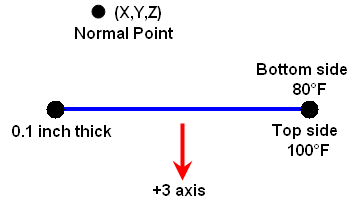

- delta T thru thickness. Regardless of the method selected in the Temperature Method drop-down menu, you can specify the temperature gradient in local 3 direction in the delta T thru thickness column. This is equal to the change in temperature across the plate divided by its thickness: delta T thru thickness = (Ttop-Tbottom)/thickness. See Figure 4. A temperature gradient causes the plate to bend but not to grow or shrink.
Figure 4: Temperature Gradient Through a Plate Element
ΔT Gradient Through the Thickness:
= (T top - T bottom) / thickness
= (100 - 80 °F) / (0.1 inch)
= 200 °F/ inch
