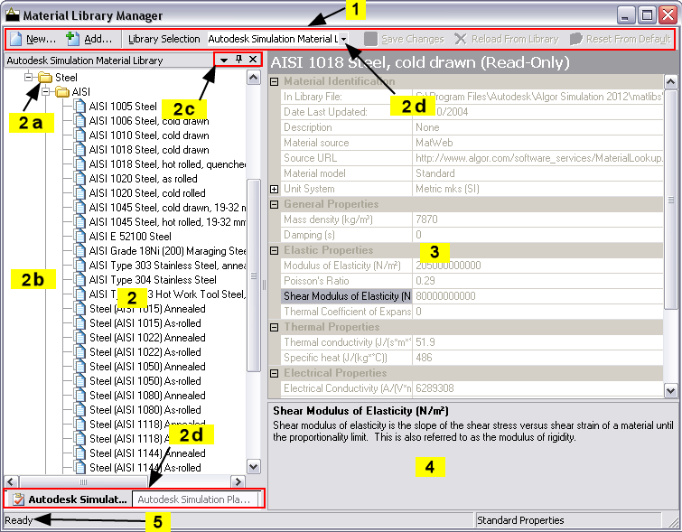

- From this dialog, you can view material data stored in the default material library or a customized material library. For example, select the Autodesk Simulation Material Library tab and select the AISI 1018 Steel, cold drawn item from the list. The properties for that material are shown (see Figure 1).

Figure 1: The Material Library Manager
The sections of the Material Library Manager are as follows:
- Toolbars with often used commands.
- The browser (tree view), which shows the list of libraries and materials. The browser is further broken down into the following area:
- Material Category (or a folder) is used to hold similar groups of materials.
- List of materials contained in each category (folder).
- Tree View or Library toolbars, consisting of the Menu toolbar (
), the Auto Hide toolbar (
), and the Close toolbar (
- The tabs at the bottom of the browser and the Library Selection pull-down show the material libraries available. Other library files may exist but are not linked to the software. See How to Access Existing Material Libraries on the Customize a Material Library page.
- The Property Grid, which shows the material properties for the selected material and permits them to be changed.
- The Help Area shows message and explanation for the selected material property.
- The Status Bar, which gives additional explanations for the commands as the mouse passes over it.
Tip: The library manager stores the material properties in a file (the library), not as part of the model. Customer defined materials or materials contained in any material library can be applied to a model by right-clicking the Material heading in the FEA Editor browser and selecting the Edit Material command. Select the material library and then select the material and click OK.
