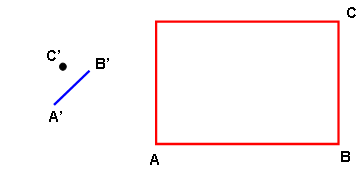

Essentially, Relocate & Scale moves, rotates, and optionally scales the selected lines from one plane (defined by three points) to another plane (also defined by three point). That is, the selected items are moved and rotated a distance equal to moving from plane A-B-C to plane A'-B'-C'. See the following figures.
When the command is initiated, the Relocate & Scale dialog will appear. You will be asked to define 6 points. The point A, B, and C are usually on the geometry being moved, but technically they can be any appropriate coordinates.
If you want line AB to be the same length as line A'B', activate the Scale check box.
(a) The red rectangle is to be moved so that point A corresponds with point A' on the blue line and rotated so that side AB aligns with the blue line. Relocate & Scale defines the six points.
(b) Imagine a right-handed coordinate system created by each set of three points.
(c) Plane AB-AC is moved and rotated to align with plane A'B'-A'C'.
(d) The final result. If the Scale check box had been activated, the base of the rectangle AB would have been the same length as the line A'B'.
