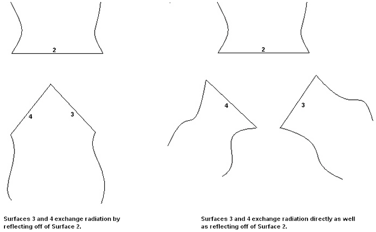

Once the radiation surfaces are defined, you must place them into enclosures. Due to reflection between surfaces, body-to-body radiation must be defined differently than other types of surface interactions that you may be familiar with. Take surface-to-surface contact for example. Surface 2 may contact Surface 3, and independently contact Surface 4. This does not mean that Surfaces 3 and 4 may contact. In body-to-body radiation, if Surface 2 can radiate to Surface 3 and Surface 4, then Surfaces 3 and 4 can exchange radiation either directly or indirectly as shown in Figure 1.
Figure 1. Surface 2, 3, and 4 (and the ambient) form one Enclosure: a set of Surfaces that radiate with each other but no other Surfaces

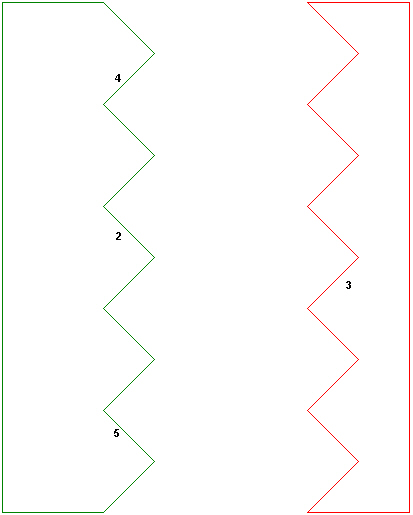

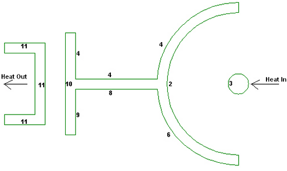

Consequently, all surfaces that see each other, directly or indirectly, form one enclosure. Figure 2 shows a model in which one enclosure would be defined. Figure 3 shows a model in which four enclosures would be defined
Figure 2. Regardless of how many surface numbers are used to define the serrations (4 are shown above), all must be defined as one enclosure. Mathematically, Surface 4 can radiate to Surface 5 through multiple reflections.
Figure 3. Four independent sets of Surfaces that radiate between each other exist. Thus, four enclosures would be defined. Enclosure 1: Surfaces 2 and 3; Enclosure 2: Surface 4; Enclosure 3: Surfaces 6, 8, and 9; and Enclosure 4: Surfaces 10 and 11

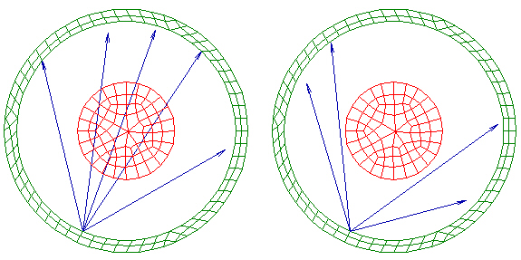

If the enclosure must take shadowing into account, select the Included option in the Shadowing drop-down box. Shadowing indicates that one body blocks the direct line-of-sight between surfaces of another body. The classic example is nested cylinders (see Figure 4). Mathematically, the inside of the large cylinder (Surface 2) could radiate across the diameter, passing right through Surface 3. To avoid this situation, shadowing should be included. (Only surfaces defined in the enclosure will have a shadowing effect). The enclosure in Figure 2 would also need shadowing Included to prevent radiation from (mathematically) passing through the body.
(a) (b)
Figure 4. Without shadowing, (a), a point on the inside of the pipe can see all other points on inside of the pipe. With shadowing (b), part of the view is blocked by the inner cylinder.
