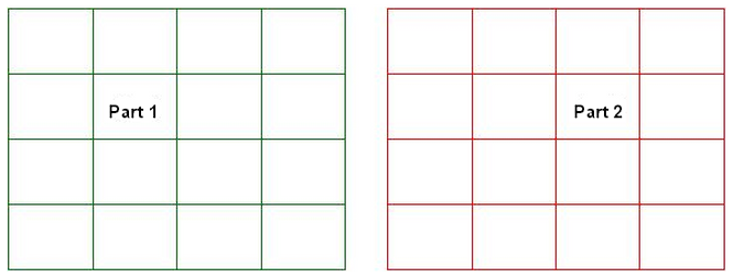

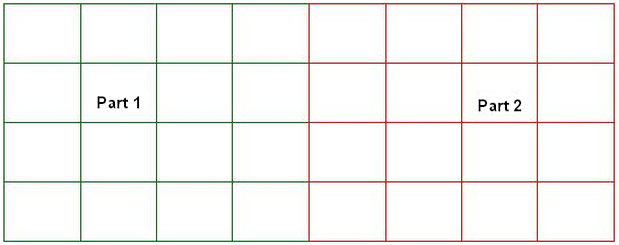

For example, you have elements of Part 1 and Part 2 that meet as shown here:
It appears that the interface only consists of Part 2 lines. However, if we separate the two parts (as shown below), we see that each part has lines at the interface as desired. This is exactly how the interface of different part numbers should be modeled so that we have complete elements for Part 1 and Part 2.
