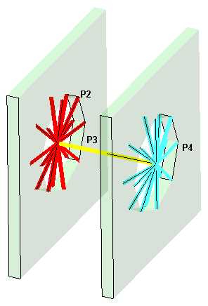

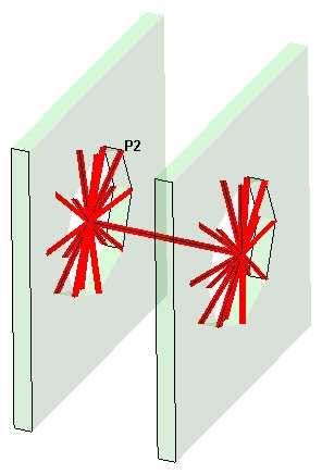

The rigid element consists of two nodes. Each rigid element part may contain an unlimited amount of elements. However, all the rigid elements in a particular part must share a single node. This common node is treated as the master node during the analysis. See the examples in the following image.
The rigid element is assigned a single stiffness value that is applied against one or multiple degrees of freedom.
Improper. Rigid elements used to connect two brackets of a larger assembly. The rigid elements (part 2, P2 in figure) are incorrect in this example. Each of the elements within the part do not share a common node. Each rigid element within a part must be connected to one node to create the proper geometry. (Brackets shown with transparency to show the rigid elements more clearly.) Proper. Each of the rigid elements in each part share one common node. In part 2 (P2), all the rigid elements are connected at one node in the center. Part 4 (P4) is the same way. Part 3 (P3) connects the two sides and can be either one element or two elements (share a node in the center). Part 3 cannot be divided into three elements because they do not share one common node.
