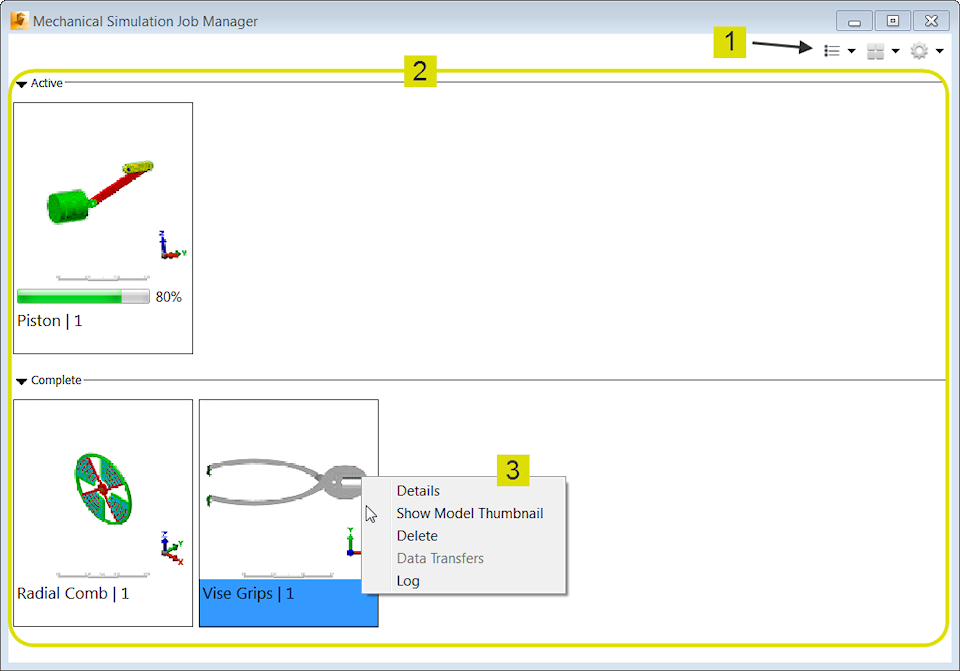

The Mechanical Simulation Job Manager contains the following elements:
Figure 1: Mechanical Simulation Job Manager (Medium Icon View Mode)
  1. Toolbar: The toolbar contains the following items:

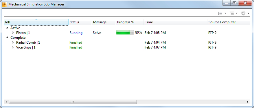

    2. Sizes: Use this menu to specify the thumbnail size (Small, Medium, or Large Icons, as shown in Figure 1) or to choose the List view option. The List view mode, shown in the following image, provides extra details.
      Figure 2: Mechanical Simulation Job Manager (List View Mode)

  2. Job View: The Job view area is divided into the following two portions, whether viewing thumbnails (Figure 1) or in the List view mode (Figure 2):
    • The Active list (top portion) monitors currently running jobs. A progress bar on each item provides an indication of how much of the simulation process has been completed.
    • The Complete list (bottom portion) shows the previously finished or canceled jobs. A yellow triangle icon with an exclamation point () appears on canceled jobs.
  3. Context Menu (Right-Click): The context menu for each job (whether thumbnail or list view) contains several tools for gaining more insight into the progress of your simulation. The options displayed in the menu depend upon the current context. In other words, not all menu choices are available in every situation:

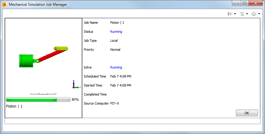

    • Details: Opens a detail view of the selected job. The detail view lists the status; job type; priority; scheduled, started, and completed time; source computer (where the solution is run); and the thumbnail image of the model. While running, a progress bar indicates the progress of the simulation. Click OK to close the detail view. An example of the Detail view is shown in the following image:
      Figure 3: Mechanical Simulation Job Manager (Detail View)
