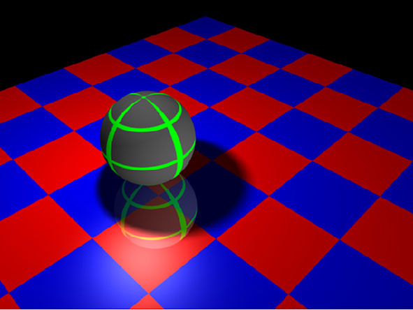

Consider the following example of an image generated in Maya.
This image was exported from Maya using the following render passes.

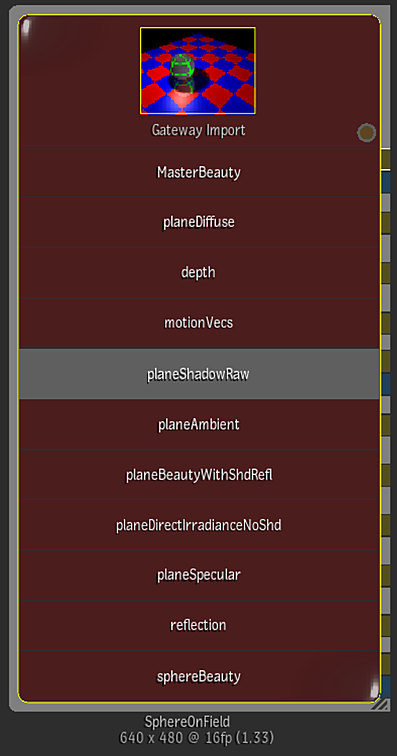

Importing this file using the Read File node, you have access to all these passes.

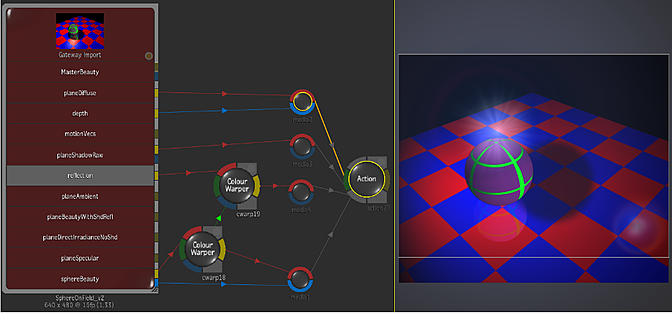

Once imported, you can create a simple ConnectFX schematic and composition.
In this ConnectFX setup, you can do the following, for example:

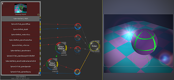

If the CG artist updates their work, you can just replace the current clip with the updated version, performing a simple replace operation; all the compositing information is maintained.
In fact, the Read File node supports matching channels based not only on their UID and name, but also on their channel type. This allows you to replace sources with multiple render passes in a clip that are similar, but not identical, and maintain schematic connections to the Read File node within a composite.
