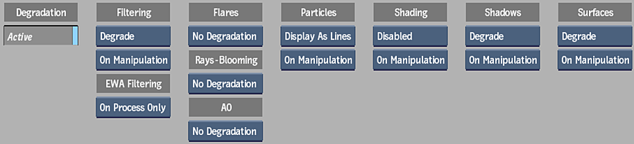

Use these settings to temporarily deactivate taxing operations during interactive manipulations. These settings do not affect the final renders.
- Active button
- Enable to activate adaptive degradation display settings. Use to prevent slowdowns of the image window display when changing Action settings. Press Ctrl+D to activate or deactivate degradation settings.
You'll see an icon
displayed at the bottom right corner of the image window when degradation is active in Action.
- Synchronize All button
- Enable to synchronize all ConnectFX Action nodes with the Adaptive Degradation settings of the current Action node.
- Filtering Degrade box
- Select whether to degrade filtering selections in the image window when changing any Action settings.
- Filtering Update box
- Select whether to always degrade filtering selections, or on manipulation only.
- EWA Filtering box
- Select whether to apply EWA or EWA+Linear filtering on maps (if selected in the Filter box) only when processing (On Process Only), or all the time when working in Action (Degrade).
- Flares Degrade box
- Select whether or not to degrade Lens Flares.
- Rays Degrade box
- Select whether or not to degrade Rays.
- Blooming Degrade box
- Select whether or not to degrade Blooming.
- Particles Degrade box
- Select a particle quality display setting.
- Particles Update box
- Select whether to always degrade particles selections, or on manipulation only.
Note: The Particles options are available in Smoke since you can load an Action setup with particles that can be viewed in the image window.
- AO Degrade box
- Select an ambient occlusion quality display setting.
- Shading Degrade box
- Select whether to degrade shading selections in the image window when changing any Action settings.
- Shading Update box
- Select whether to always degrade shading selections, or on manipulation only.
- Shadows Degrade box
- Select a shadow quality display setting.
- Shadows Update box
- Select whether to always degrade shadows selections, or on manipulation only.
- Surfaces Degrade box
- Select a surface quality display setting.
- Surfaces Update box
- Select whether to always degrade surfaces selections, or on manipulation only.
- Motion Blur Degrade box
- Select whether or not to degrade Action motion blurs in the pipeline.
- Software AA Degrade box
- Select whether or not to degrade Action software anti-aliasing in the pipeline.
- Depth of Field Degrade box
- Select whether or not to degrade Action depth of field in the pipeline.
