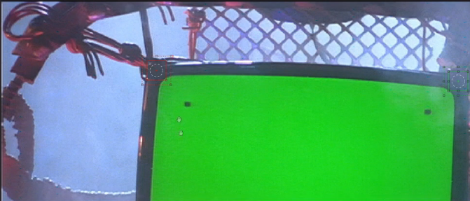

You can apply the tracking information from one point to another point in the image. A dotted line is displayed between the tracker and the offset target, using the Offset Reference tool. This is useful when you want to track a portion of an image that does not have an adequate tracking anchor point.

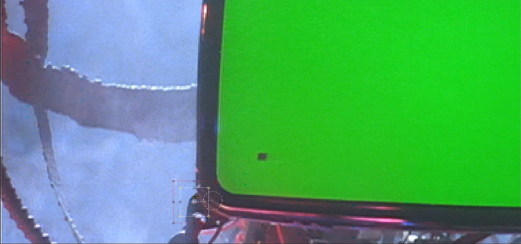

To resolve this, we can offset the reference. To do this, proceed as follows:
This enables you to place the tracker on a proper anchor point, but apply the tracking data to the original portion of the image, which does not have an adequate anchor point.

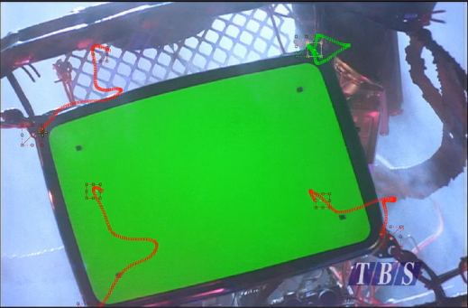

The motion is tracked. The reference is the anchor point on which the tracker was placed, but the motion is applied to the offset target.

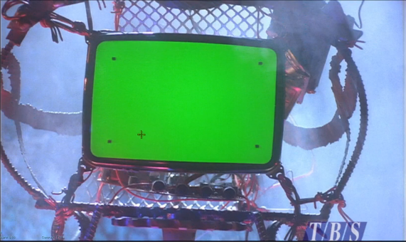

The tracking data is applied to the offset targets. The corners of the replacement image are still at their original position, where there were no adequate anchor points, but the motion and the positioning is correct.
