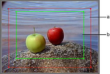

To crop gesturally in the image window:
  1. Double-click the Crop field to enable Crop and Softness.
  2. In the View box, select Media Front or Media Matte.
    The clip appears in the image window with a red outline, which indicates the Crop box, and a green outline, which indicates the Softness box.
    (a) Crop box  (b) Softness box  
    Tip: You can use two viewports to view the crop interactively on both the front and the matte clips.
  3. Set the corners of the Crop box and Softness box by dragging either the corners or edges of the red and green outlines.
    The crop and softness values in the Media list are updated as you drag.
  4. Click Result.
    The cropped media appears in the image window, and the front and matte clip share the same crop.
