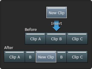

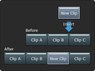

Insert Example 1
Insert Example 2

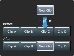

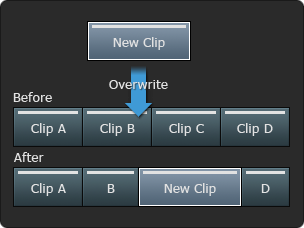

Overwrite Example

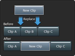

Replace Example | Select: | To apply: | Example |

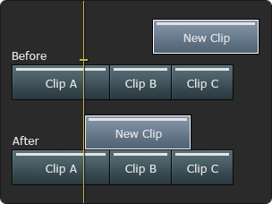

| Aligned Edit | An edit aligning a point on the timeline with a point on the source clip. |

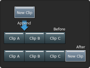

| Append | An insert edit that adds your source clip to the end of the edit sequence on the timeline. |

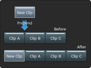

| Prepend | An insert edit that adds your source clip to the beginning of the edit sequence on the timeline. |
| Ripple Replace | A combination of an insert and replace edit; where the source clip replaces the selected clip on the timeline, and the all of the clips to the right ripple to accommodate the length of the new clip. |

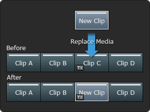

| Replace Media | A replace edit that retains any effects applied to the replaced clip or clips on the timeline. |

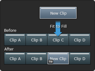

| Fit To Fill | A replace edit; but instead of adding tail frames to a longer source clip, a timewarp is added to the replacement clip so that it fits the same duration occupied by the clip it is replacing. |

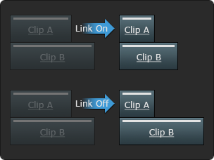

| Select Backward / Forward | Select one of four options: Single Track Forward, Single Track Backward, All Tracks Forward, or All Tracks Backward. When selected, a single click on a Timeline segment selects one or all segments before/after the segment. The state of the Link button affects the selection. | |

Link Example
