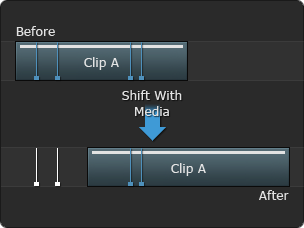

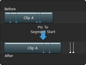

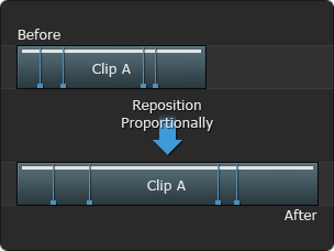

- Select how the animation channel is affected when you slide the animated effects by choosing an option from the Keyframe Move Modes box.
| Select: |
To: |
Example |
| Reposition Proportionally |
Resize the channel as you trim. The animation channel is scaled to fit into the timeline element. This option has no effect when you slip or slide. |
| Shift With Media |
Link the keyframes to their original frame numbers. The animation channel moves to follow the original frames as you trim. |
| Pin To Segment Start |
Unlink the keyframes from their original frame number. The animation channel remains with the timeline element as you trim. |
