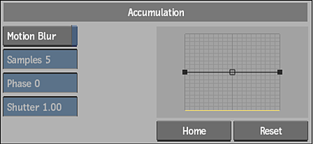

Accumulation Settings
Use the Accumulation settings to define motion blur properties.
- Global Motion Blur button
- Enable to use motion blur. Once enabled, specific Action object Motion Blur buttons can be enabled or disabled. See About Motion Blur for specific examples of creating motion blurs.
- Samples field
- Displays the quality of motion blur and the depth of field produced by the number of samples taken at each frame. Editable.
Increasing this value causes the processing time to increase linearly and affects the quality of the depth of field. The number of motion blur samples is multiplied by the number of anti-aliasing samples. To reduce the total number of passes made for each frame, reduce the level of anti-aliasing when motion blur is enabled.
- Phase field
- Displays the frame that motion blur is based on (before or after the current frame). Editable.
A value of -100 places the motion blur before while a value of 100 places the motion blur after. A value of 0 is centred, which evenly distributes the motion blur. The default value is 0.
- Shutter field
- Displays the duration of motion blur at each frame (essentially the number of frames that the shutter is open). Increasing this value does not increase the processing time. Editable
Tip: You can animate the Global Motion blur button, as well as the Phase, Shutter, and Samples fields. They can be found in the Channel Editor under the motion_blur folder.
- Motion Blur curve
- Controls the sample weight over the scope of the motion blur.
- Home button
- Resets the position of the motion blur curve after panning.
- Reset button
- Resets the motion blur curve.
