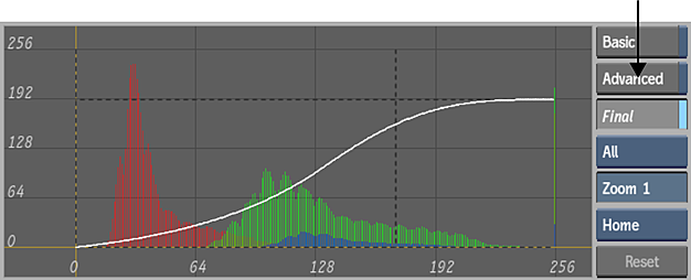

The modifications you make to the basic conversion LUT curves and the advanced editing curves are independent. The final LUT that you generate, however, is a single curve (or set of R, G, and B curves) that consists of basic LUT curves and adjustments you make with advanced editing curves.

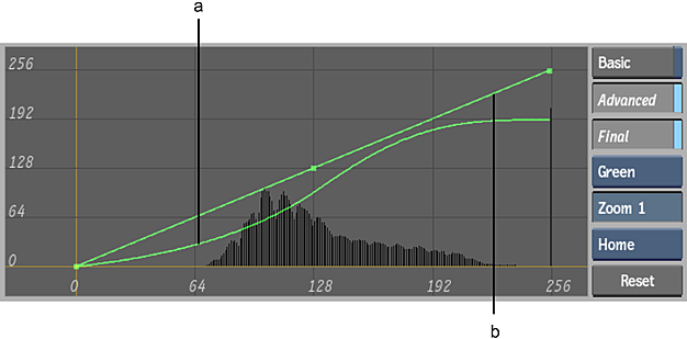

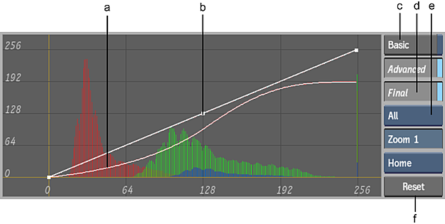

Additional advanced editing curves appear for the red, green, and blue channels. RGB curves use blending to distinguish overlapping curves. For example, when all RGB curves overlap, a white curve is produced, whereas green and blue overlapping curves produce a cyan curve.
(a) Red, blue and green overlapping advanced editing curves (b) Control point (c) Basic button (d) Final button (e) Edit Curve box (f) Reset button
The corresponding channel's basic and advanced editing curves are displayed. The histogram only displays values for the selected channel.
(a) Color channel selected in Edit Curves box (b) Color channel's advanced editing curve

Dragging control points of advanced editing curves affects the basic curves and the colour effect is immediately reflected in the clip.
