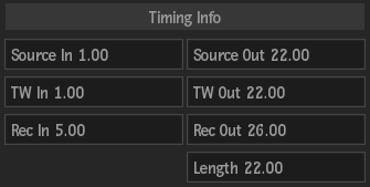

Timing Info Settings
These settings are only available if you accessed Timewarp as a Timeline FX, and entered the full editor. They are informational settings only, to give you information about the segment on the timeline.
Source In field
Displays the frame or timecode of the In point of the source segment. Non-editable.
Source Out field
Displays the frame or timecode of the Out point of the source segment. Non-editable.
Timewarp In field
Displays the frame or timecode of the In point of the timewarp result. Non-editable.
Timewarp Out field
Displays the frame or timecode of the Out point of the timewarp result. Non-editable.
Record In field
Displays the frame number or Record timecode of the In point of the segment in the sequence. Non-editable.
Record Out field
Displays the frame number or Record timecode of the Out point of the segment in the sequence. Non-editable.
Length field
Displays the length of the segment. Non-editable.
