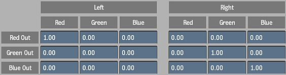

| Select: | To: |
| Custom | Customize the RGB left and right gain factor values. With this option, you can create anaglyph results based on the 3D lenses that will be used. Note: This option is available in ConnectFXand the Modular Keyer.
| Dubois | Reduce ghosting between the left and right eyes. |
| RGB | Create an anaglyph result based on the RGB values. |
| Mono | Remove the RGB values before creating an anaglyph result. With this option, you will see just the stereo effect. |
