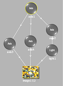

For example, in the following schematic, Axis 1 is selected.
The tabs in the Object menu appear as follows. The image1 tab appears in light blue to signify that multiple objects are connected down to it. Use the tabs to switch between menus within the Object menu. The Camera tab appears in orange as the first tab on the right side of the Object menu, and is exempt from the tab population rules.

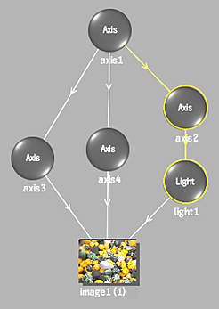

For example, in the following schematic, light 1 is selected.
Since Light 1 is not the top object in its branch, the tabs in the Object menu appear as follows.

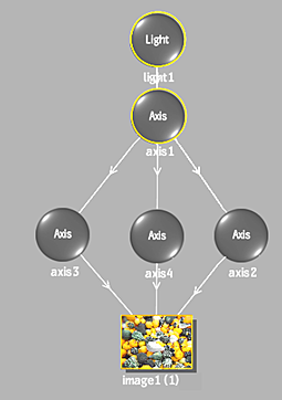

In the following schematic, light 1 is moved to the top of the branch.
