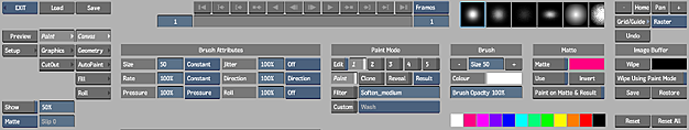

The Paint menu appears.
| Click: | To: |
| Paint | Use the brushes or geometric shapes to paint on the canvas, record and apply strokes to the canvas, fill areas of the image with a reference colour or image, and move the image on the canvas. |
| Graphics | Create, edit, and animate shapes and apply them to the canvas. |
| CutOut | Create and add effects to cutouts and apply them to the canvas. |
| Setup | Set preferences, rendering options, grid guides, and colour correction options. |
