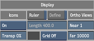

Display Settings
Icons box
Select object icon (axes, borders, control points) display options. The selected option displays icons only for the object currently selected in the scene.
Icon Transparency field
Displays the transparency level for icons in the scene. Editable.

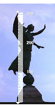

Ruler button
Enable to display the ruler in the scene area. Use the arrows at each extremity of the ruler to place the beginning and end of the ruler anywhere in your scene view.
Tip: Use the Shift key to snap the ruler into place either horizontally or vertically.
Ruler Define button
Enable to define real unit measurements, such as feet, metres, or inches, instead of pixels. All camera distance or axes measurements thereafter use the defined scale.
Ruler Length field
Displays the length and measuring unit (feet, metres) to use in Action. When you enter a length, click Define again to apply the new scale to the ruler and all pertinent fields, such as position, rotation, and scale. Editable.
Tip: Hold the Ctrl key and click Define to reset the ruler’s scale.
Grid Colour pot
Displays the custom colour for the grid. Editable.
Grid box
Select the type of grid to display in the scene. Use to position objects in the scene more accurately.
Select: To:
Grid Off Disable the grid.
Grid XY Use a grid constructed on the X and Y planes.
Grid XZ Use a grid constructed on the X and Z planes. The XZ grid is visible only when the camera is moved from its default position.
Grid YZ Use a grid constructed on the Y and Z planes. The YZ grid is visible only when the camera is moved from its default position.
Note: The Action grid is independent from the global grid in the Grids and Guides menu.
Ortho Near field
Displays the value of the near view in the image window when using Camera or an orthographic view. Editable.
Ortho Far field
Displays the value of the far view in the image window when using Camera or an orthographic view. Editable.
