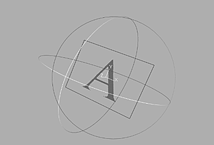

You can rotate an axis in the scene, as well as objects that do not have exclusive axes such as lights.
To rotate an axis directly in the scene:
A trackball appears in the scene. The trackball consists of three concentric rings. Each ring is used to rotate the object and its axis around one of the three axes.
The axis and its object rotate in the image window. If the Axis menu is displayed while you rotate, you can see the Rotation fields update after the axis is rotated to its new position. You can also rotate the axis by dragging any of the Rotation fields in the Axis menu.
