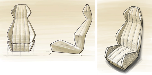

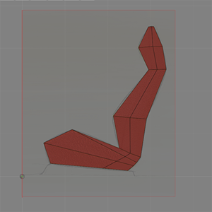

- First scribbles from the stylist
- Aim: Quick volume to see proportions

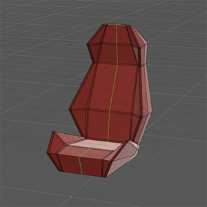

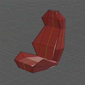

- When simplified the seat consists of segments
- Details and fillets are ignored for now
Steps

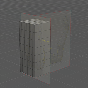

- Create a box with 2x6x7 faces.

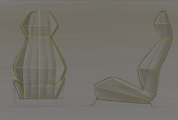

- Adjust the side view.
- Adjust the front view.

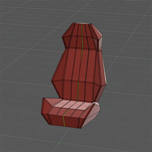

- Adjust in 3D.

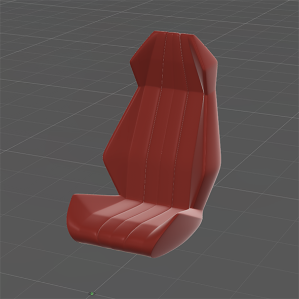

- Refine.
- Add details.
