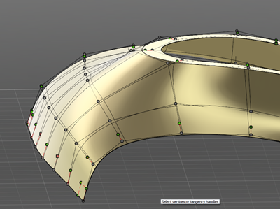

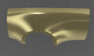

- The model has been created and looks the way it should

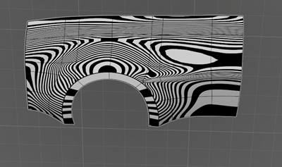

- However, the surface is messy from all the moving around
- Moving points never seems to really clean it up

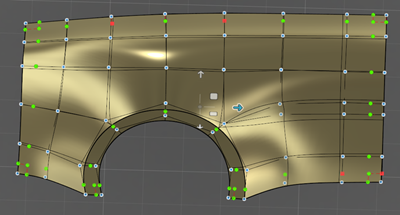

- Control Frame Display and Orthographic view are the best settings
- The surface is visible but also the frame that defines its shape

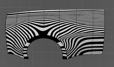

- Create clean, regular rows of control frame points

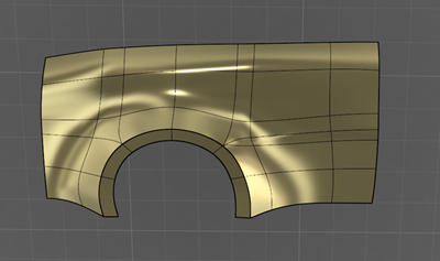

- While it will never be Class A quality, the surface has reasonably good highlights
