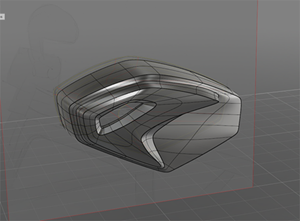

Motorcycle tank cover example
- Aim: shape milled in clay for manual adjustments
- Theoretical edges are required
Strategy
- Build strips of faces to define the edges
- Make the surfaces in-between flat
- Define the curvature of the surfaces in a second step
Steps

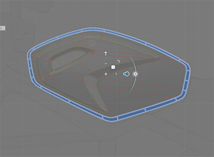

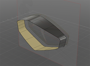

- Create first strip of faces.

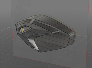

- Create first extrusion.

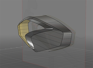

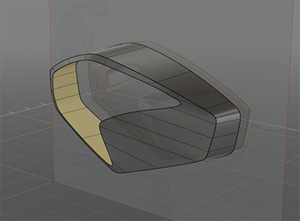

- Create second extrusion.

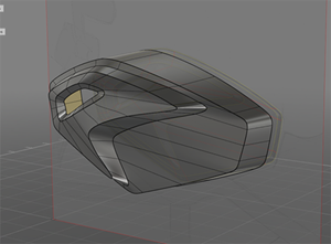

- Adjust shape.

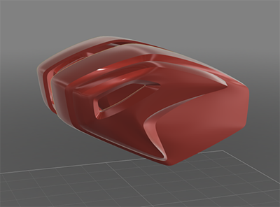

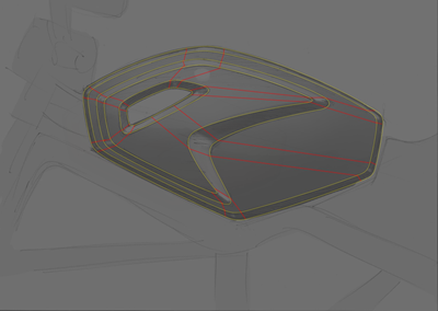

- Add edges and curve surfaces.
