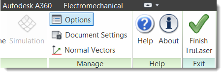

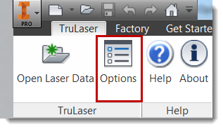

The Options location varies in the TruLaser ribbon based on whether you are starting up TruLaser:
Or, are already viewing a laser data file:
