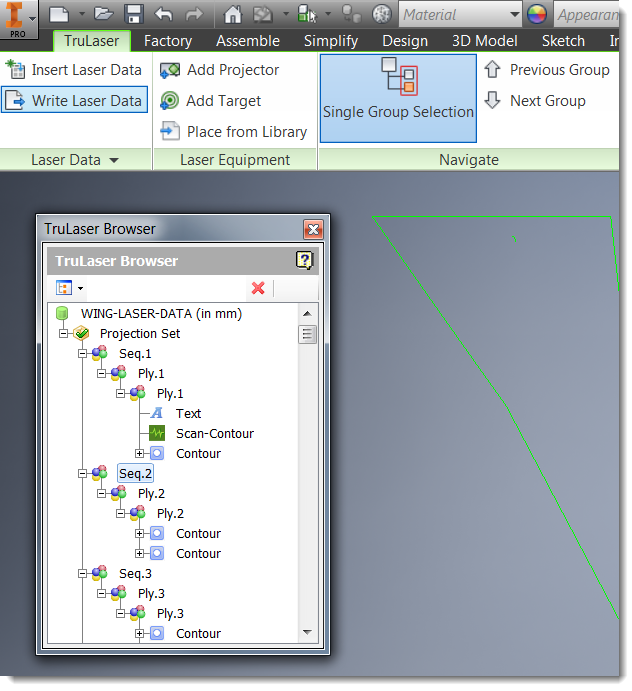

View Data in Group Mode
Single Group Selection simulates the laser projection by only showing one group of laser data at a time. The first group shown is the first group of laser data displayed by the laser projector.
Click Previous Group to change the display to the next mode up in the list. Click Next Group to move to the next group down in the list.
