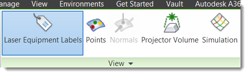

View Projector and Target Labels
Laser Equipment Labels toggles projector and target labels on and off in the display. Labels help track where target points and projectors are in the context of your assembly. They also provide reference points as you begin to apply composite layers.

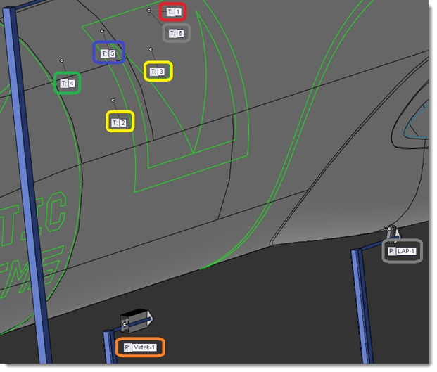

Laser projector labels start with a P followed by the name of the projector as it appears in the projection tree. Target points start with a T, followed by the name shown in the tree.
