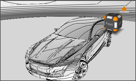

Adjust Settings in Isophotes Mode
In Isophotes mode, a virtual light source provides defuse illumination to the object geometry. All points sharing the same brightness value are connected with a line.
Surface Analysis Off Surface Analysis On - Isophotes Mode
  1. From the Analysis Mode box of the Surface Analysis dialog box, select Isophotes.

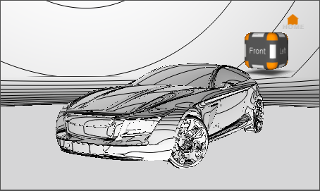

Adjust Settings in Reflection Lines Mode
In Reflection Lines mode, lines on a virtual plane are reflected onto the surface of the geometry.
Surface Analysis On - Isophotes Mode Surface Analysis On - Reflection Lines Mode (Parallel Linear Lines)
  1. From the Analysis Mode box of the Surface Analysis dialog box, select Reflection Lines.
  2. Select Parallel Linear Lines on a Plane.

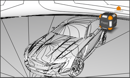

  4. Alternatively, select Longitudinal Lines on a Sphere under Analysis mode.
    This creates a sphere with lines reflected on the geometry.
