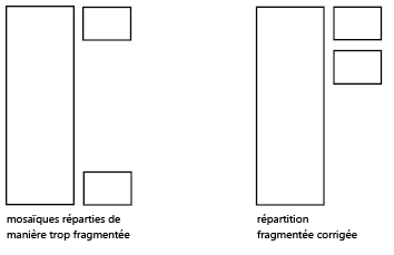

If two adjoining columns differ greatly in the amount of space their tiles occupy, then the tiles in the one that needs less space may appear to be distributed too far apart. Their appearance can be improved if you set the incongruous column's fixed_height attribute to true. The result for vertical tile distribution is shown in the following diagram:
