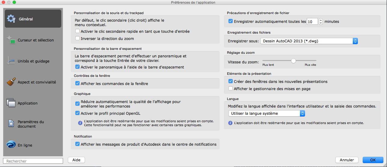

General Tab (Application Preferences Dialog Box)
Controls the behavior of program features.
List of Options
The following options are displayed.
Mouse & Trackpad Customization
Controls the behavior of the mouse or trackpad.
Enable Quick Secondary Click as Return Key
Controls right-click behavior. A quick click is the same as pressing Enter. A longer click displays a shortcut menu. You can set the duration of the longer click in milliseconds. (DBLCLKEDIT system variable)
Reverse Zoom Direction
Toggles the direction of transparent zoom operations when you scroll the middle mouse wheel. (ZOOMWHEEL system variable)
Spacebar Customization
Controls the behavior of the spacebar when pressed or held.
Enable Spacebar Hold to Pan
Toggles if you can hold down the Spacebar to enable panning. (SPACEPAN system variable)
Viewport Controls
Controls the display of the menus in the upper-left corner of all viewports.
Display the Viewport Controls
Controls whether the menus for viewport tools, views, and visual styles that are located in the upper-left corner of every viewport are displayed. (VPCONTROL system variable)
OpenGL
Provides you the ability to activate OpenGL Core Profile if you are working in OpenGL Legacy profile.
Activate OpenGL Core Profile
Activates OpenGL Core Profile if you are working in OpenGL Legacy profile.
Note: For the change in core profile to take effect, you need to restart AutoCAD.
File Save Precautions
Assists in avoiding data loss.
Automatic Save
Saves your drawing automatically at the intervals you specify. You can specify the location of all Autosave files by using the SAVEFILEPATH system variable. SAVEFILE (read-only) stores the name of the Autosave file.
Note: Automatic save is disabled when the Block Editor is open.
Minutes Between Saves: When Automatic Save is on, specifies how often the drawing is saved. (SAVETIME system variable)
File Save
Saves your drawing in a DWG and DXF format of your choice.
Save As
Provides you a list of standard drawing formats to save your drawing as.
Zoom Adjustment
Controls the zoom behavior of the input device.
Zoom Speed
Controls how much the magnification changes when the mouse wheel is rolled forward or backward, or you single swipe on Magic Mouse or a trackpad. (ZOOMFACTOR system variable)
Layout Elements
Controls the tasks that the program performs when a new layout is created.
Create Viewports in New Layouts
Creates a single viewport automatically when you create a new layout. (LAYOUTCREATEVIEWPORT system variable)
Show Page Setup Manager
Displays the Page Setup Manager the first time you click a named (paper space) layout. Use this dialog box to set options related to paper and print settings. (SHOWPAGESETUPFORNEWLAYOUTS system variable)
Adaptive Degradation
Controls settings related to configuration of the graphics display system.
Automatically decrease display quality to improve performance
Controls whether adaptive degradation is on or off. With adaptive degradation on, if performance goes below a specified level, effects are disabled or reduced to maintain an acceptable level of performance.
