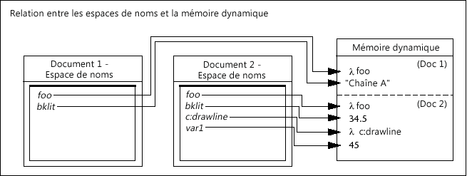

The concept of namespaces was introduced to prevent applications running in one drawing window from unintentionally affecting applications running in other windows. A namespace is a LISP environment containing a set of symbols (for example, variables and functions). Each open AutoCAD drawing document has its own namespace. Variables and functions defined in one document namespace are isolated from variables and functions defined in other namespaces.

VLISP provides ways for you to share variables between namespaces, but you must take explicit action to do so. (See About Sharing Data Between Namespaces [AutoLISP].)
Like variables, functions defined in an AutoLISP file are known only to the document that was active when the file was loaded. The functions in the file are loaded in the current document's namespace and are known only to that document.
