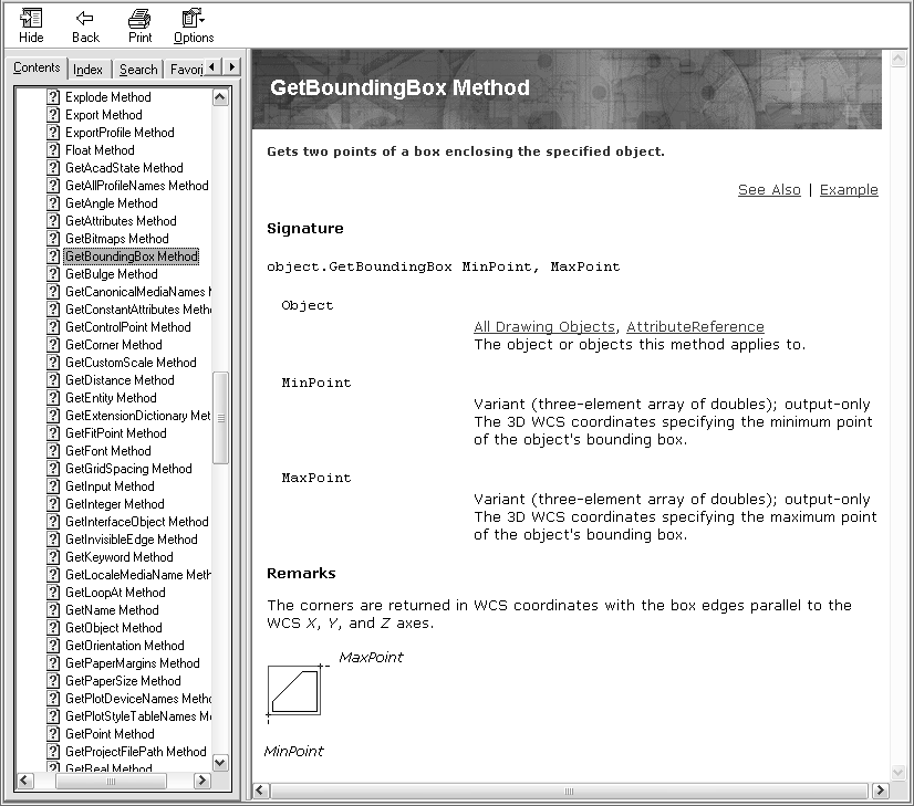

Some ActiveX methods require that you supply them with variables into which the methods can place values. The GetBoundingBox method is an example of this type of method. Here is how it is defined in the ActiveX and VBA Reference:
Note that the MinPoint and MaxPoint parameters are described as output only. You must provide output arguments as quoted variable names. The following example shows a VLISP function call to return the minimum and maximum bounding points of a circle:
