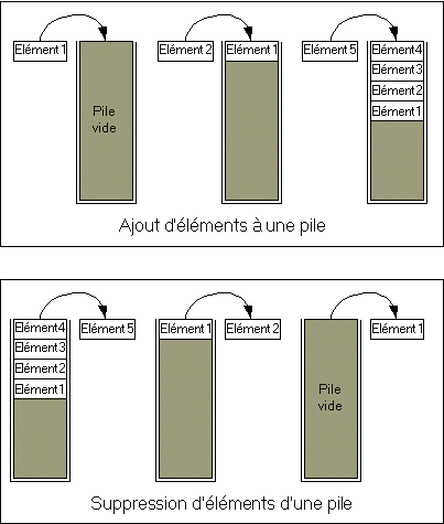

VLISP has a special debugging tool called a trace stack which is a historical record of the execution of functions within your program. (The term stack is derived from a computer programming structure of the same name.) The following figure illustrates adding and removing items from a stack. You can see why a stack structure is often referred to as LIFO—Last In, First Out:
