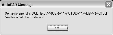

The PDB feature checks a DCL file for errors the first time you load it. If AutoCAD encounters a syntax error, a misuse of attributes, or any other error (such as failure to specify a key attribute for an active tile), the PDB does not load the DCL file. Instead, AutoCAD either displays one or more dialog boxes alerting you to the error, or writes a list of errors to a text file called acad.dce. If AutoCAD writes the error messages to acad.dce, it alerts you to this with a message similar to the following:
You can inspect the contents of acad.dce to find the problem. AutoCAD places the acad.dce file in the current working directory. When AutoCAD reads a DCL file successfully, it deletes the acad.dce file.
