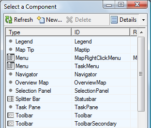

Components will be inserted in any DOM container object with a matching ID, not just in <DIV>s. So you can also use Jx methods, such as Jx.Panel and Jx.Layout to structure your page. For example, this will create an object that will have a legend inserted:
var p1 = new Jx.Panel({label: 'Legend'});
If there is no matching component for the ID, then when the user configures the flexible web layout, Infrastructure Studio will display an empty tab for it (one with no components added). The user can then add components to it through Infrastructure Studio. The ID will be used for the tab’s title, so use IDs that will help the user understand what he or she is configuring.

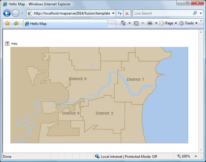

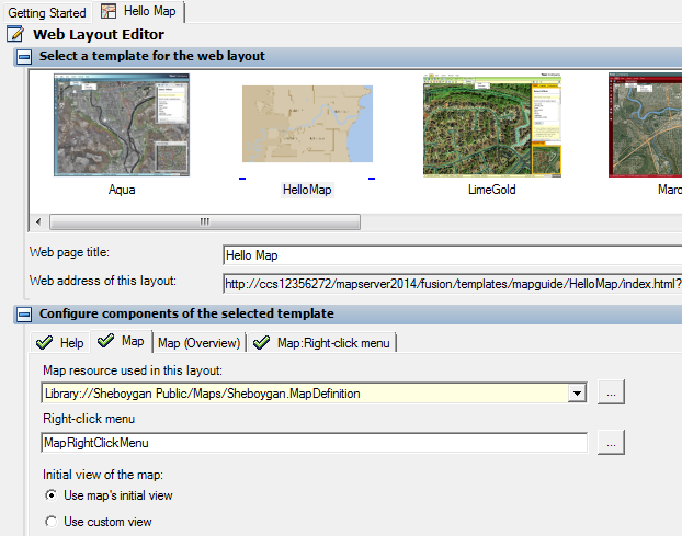

The template can now be used in Infrastructure Studio just like any of the default templates.
If you create a flexible web layout based on this template, it will look like this:
If you edit a template’s index.html file, right-click the preview image in Infrastructure Studio and choose Refresh to see the changes. If you change any of the other template files, such as modifying or adding a <Panel> element, also right-click on one of the panel tabs and choose Refresh Panels to update the panel definitions.
