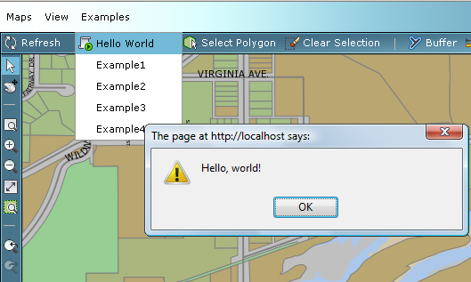

The example layout includes an Invoke Script widget that displays a JavaScript alert.
To run the Hello World example, open the flexible web layout in a browser. Click Examples menu
Hello World. This displays the alert.
