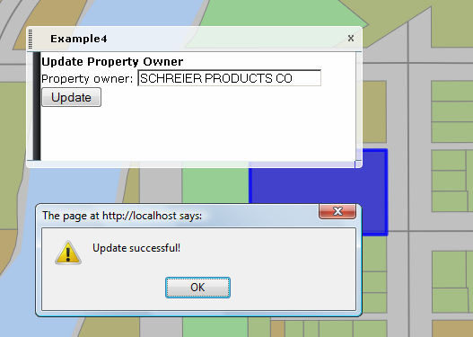

Example 4 creates a dialog that displays the owner of the current selection and allows it to be edited. The updated owner name is sent to a page on the web tier for updating in the feature source. It uses the following files in the folder C:\Program Files\Autodesk\Autodesk Infrastructure Web Server Extension 2016\www\fusion:
Example 4 is very similar in structure to Example 3: Dialogs and Events. It uses a dialog that updates based on the events Fusion.Event.MAP_SELECTION_ON and Fusion.Event.MAP_SELECTION_OFF. Instead of simply displaying the selection information, though, the dialog has an input field so the user can edit the owner of the currently selected parcel.
The initialization code for the dialog, in Example4.js, creates the form with an input text field and button, and sets the onclick action for the button.

The widget updates the dialog whenever the selection changes.
If a user clicks the update button, the widget sends the new owner name to a page on the web tier, using an Ajax.Request object from the Prototype JavaScript framework. It expects the web page to return results in a JSON object.

alert('Update successful!');
